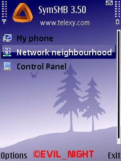

4. Once u open the application, u will c 3 options My phone, Network neigbhour hood, and Control Panel

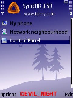

5. Now let ur first configure the Control panel.

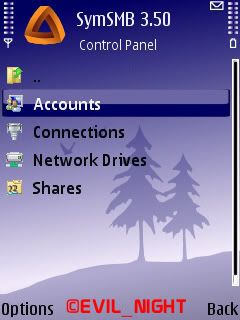

6. The 1st option u c is Account , if u want ur device not be secured and connect without any authenciation , u can use this "EVERYONE" as it does not contain any login details.

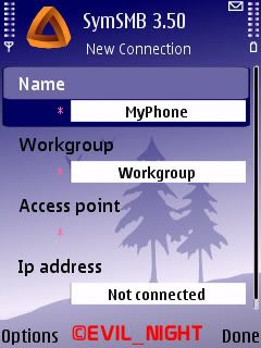

7. Now Goto Connections , select New
8. In the NAME - Give a name that u wish to connect wen u want browse ur phone shared files.
9. In WORKGROUP - Give ur PC workgroup name , in my case i have MSHOME , in order to check it , in ur pc goto System Properties -> Computer name, click Change if u want to change ur workgroup
10. In ACCESS POINT - Select a Valid access point , which u usually use to browse internet.
11. In IP ADDRESS - Just leave it blank , it will show when u get connected to the pc.

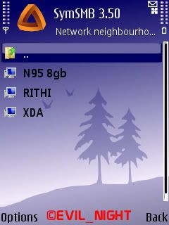

12. Now let us move to Mapping a Network drive , goto Network Neigbhourhood
13. Select the access point , wait for few seconds , as it tries to connect to the wireless router.

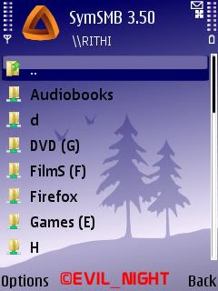

14. Once u get connected , it will show whole workgroup computers ,
15. Now select the computer u wish to connect , once connected it will show all the shared folders of the pc

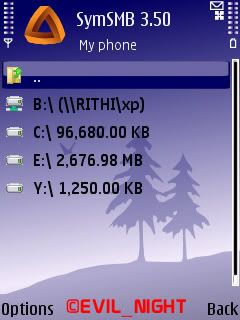

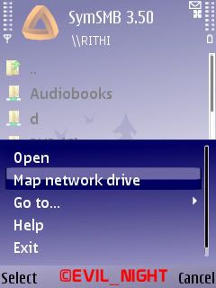

16. To MAP a drive goto OPTIONS -> Map Network drive
17. Once mapped , it can be found at My Phone
18. Now let us c how to share the phone files, Goto Shares
19. Once u enter SHARES , in FOLDER - Browse the folder , select the folder u wish to share to the pc by clicking SELECT(Left soft key) , in NAME - Give a name for the folder , by default folder name is selected , u can change if u want to.

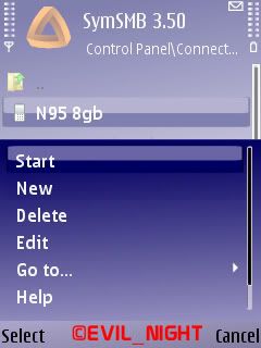

20. Now everything is done , to start a connection, goto CONTROL PANEL -> CONNECTIONS, click START , it will connect to ur wireless router
21. Once the connection is made it will prompt with ur phone ip address, u can access the shared files by typing ur device name or ip addrees .

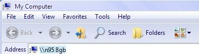

22. Now open My Computer , and type the device name in the address bar
23. VIOLA, if u have done everything correctly , u would be seeing the shared folders of ur phone.

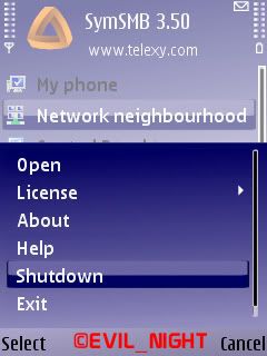

24. To disconnect the connection , u can either give STOP or SHUTDOWN

9- Khi không chia sẻ files giữa Phone và PC thì vào Control Panel – Connections – NokiaE65 – Options – Stop để ngắt kết nối. Phone sẽ không được cấp IP, tiếp tục Options – Shutdown (để ngắt hoàn toàn phone ra khỏi mạng). Không nên để kết nối khi không có yêu cầu chia sẻ file vì v/đ security và tiết kiệm pin của phone (nếu phone ra ngoài vùng phủ sóng của WLAN, nó sẽ thường xuyên tự động tìm kết nối, sẽ rất tốn pin và dễ nóng máy).
